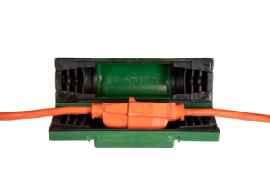

ELECTRICAL COVER      CONTAINERS
Place the connectors of the two cords into this container and clamp it down; it is that easy!
  • Weatherproofs connectors
  • Keeps cords in place
  • Wide variety of use
  • Bulkier than other approaches
  • Can become costly depending on the number of cords

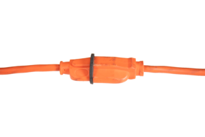

WEATHERPROOF GASKETS
Simply place the gaskets where the two cords connect.
  • Low profile
  • Can be reused
  • Can be easily lost
  • Does not hold cords in place
  • Can become costly

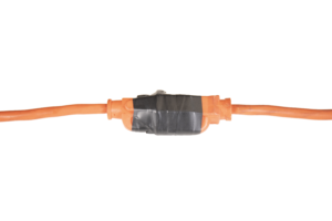

ELECTRICAL TAPE
People have used this approach for years, and it typically does the job at a low price. Make sure the  electrical connection point is tight, and use the tape with a two-thirds overlap.
  • Affordable
  • Can trap moisture in
  • One time use
  • Produces a lot of waste
