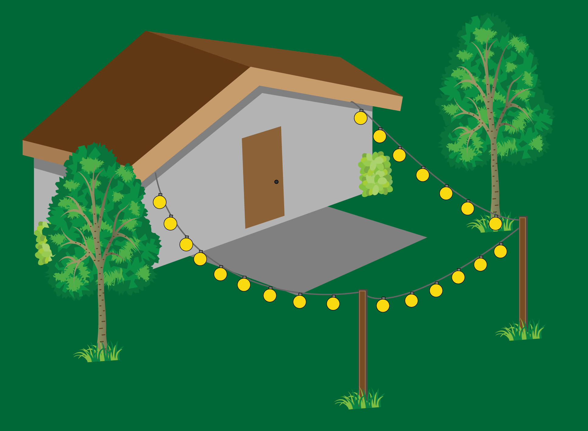

Perimeter Layout
Bistro Lights Square Layout
This layout is a straightforward approach that outlines the patio and provides light within.

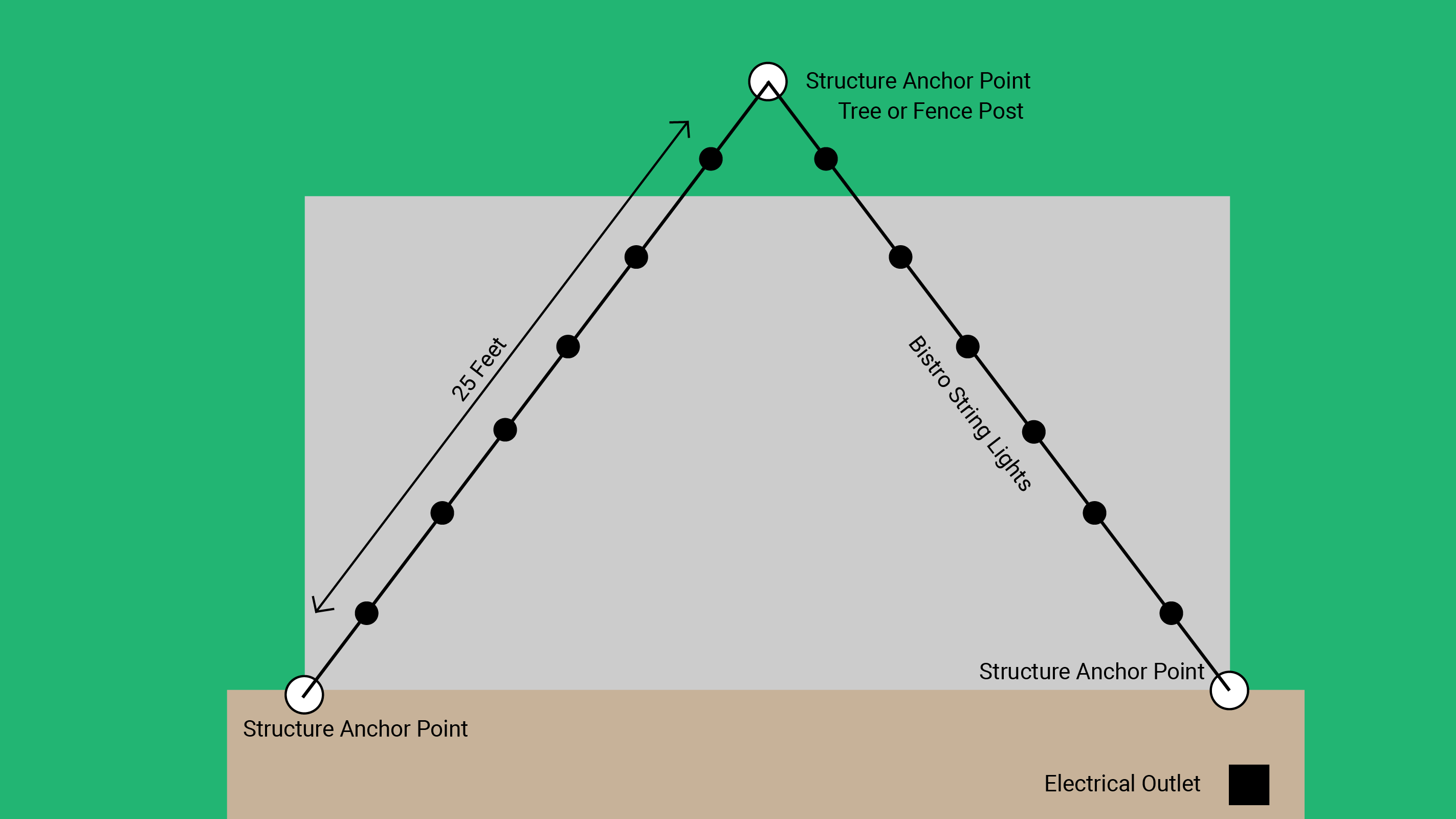

V Layout
Bistro Lights V layout
This is one of the simplest layouts, and it requires minimal materials.  Anchor the string lights to the house, run them to a structural support point at the opposite end of the patio, and then run them back to the house.

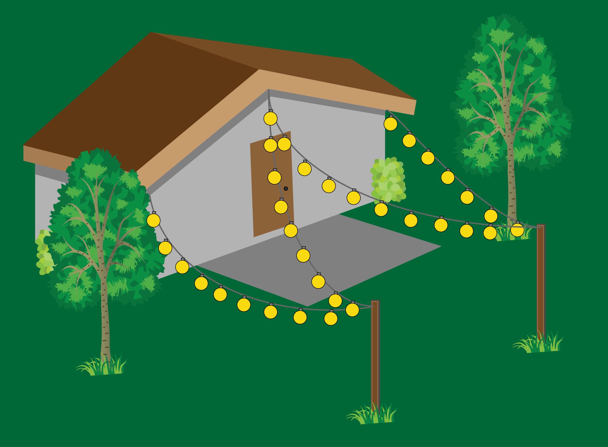

W Layout
Bistro Lights W Layout
This bistro light pattern is more difficult because it requires more structural points to secure the lights, such as trees or posts, and longer light strings. However, this light pattern will cover the whole patio with plenty of light.
